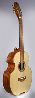

I'm making the guitar/cittern in conjunction with Gavin Davenport (of Hekety and Crucible). I went to a weekend workshop he gave on playing citterns and offered to make a guitar cittern for him that he could "road test" for me. He plays in GCGCD and has 2 archtop citterns (a Sobell and a Toenjes) that are arond 630mm scale length (24.8") and also plays a Fylde guitar of this scale length in CGCGCD, so the guitar-cittern will be this scale length too. I'm going to do a 16 fret body join as per my guitar bouzoukis but base it around a more Grand Concert'ish shape - 15" lower bout and between 4-4.5" body depth. I'm into Celtic Festivals as names so the beast is going to be called Beltaine.
I've made a "Mini-Me" cittern called "Imbolc" based around my travel bouzouki, with 605mm scale length (23.8")which I play in GDADE tuning and this is great fun. Here's a pic although it isn't fully finished yet.

That's too cool Dave!

Love that "Mini-Me".
